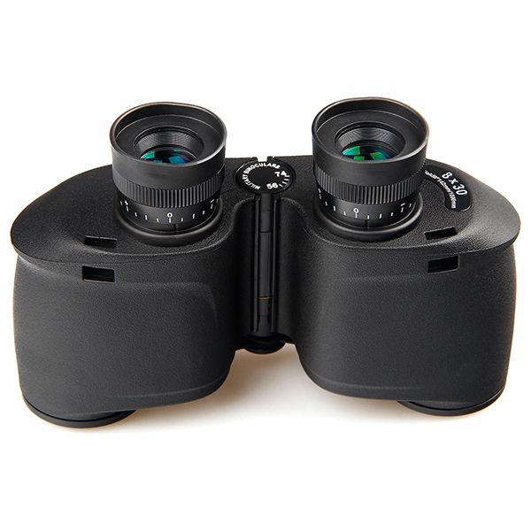

COMET 8x30 HD Porro
Prism Type: BAK4
Eye Relief: 0.59in / 15mm
Lens Coating: Fully multi-coated
Exit Pupil: 0.15in / 3.75mm
Optical Design: Porro prism
Field Angle: 8Degrees
Application: Birding
Field of View @ 1000m: 140m/1000 M
Objective Lens Diameter: 30mm
Field of View @ 1000yds: 459ft/1000yds
Cijena: 65$
